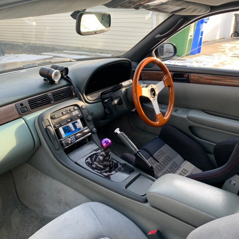

Fast forward to 2021. Living in California and having decided I would be moving back to Chicago in the following year or so, I realized I didn't want to lose ties with the drift community in NorCal and wanted another car to keep out that way so I'd have something to continue visiting and driving events with my Run Up teammates. Felt like this was a good opportunity to follow through on those JZZ30 dreams. I didn't want to deal with a swap or another full blown build (lol) so I proceeded to spend a few weeks looking through import sites without much luck. Had a friend send me a FS ad from a good Canadian pal with a car that had everything I was looking for at the right price. Hit him up and ended up buying it 2 weeks later.
