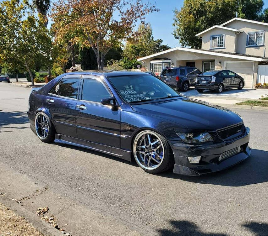

Hello all, my name is Nic from Chicago IL. I've been a drift nerd since first witnessing Ueno's Soarer at the D1GP Soldier Field event circa 2009. I will attempt to make this as complete as possible since I've half assed build threads in the past. Apologies in advance for the length.

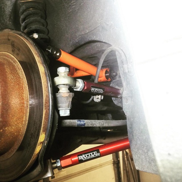

Also decided to start upgrading a few things in the car. Bought a new set of Stance SS coils with Swift springs (24k/20k) to replace the blown set on the car, as well as Serialnine FUCA's, roll center adjusters, Hotchkis sways, FIGS endlinks, a Kaaz 2 way to replace the factory Torsen + 3.9 final drive, poly bushings, and Battle Version rear toe/traction links

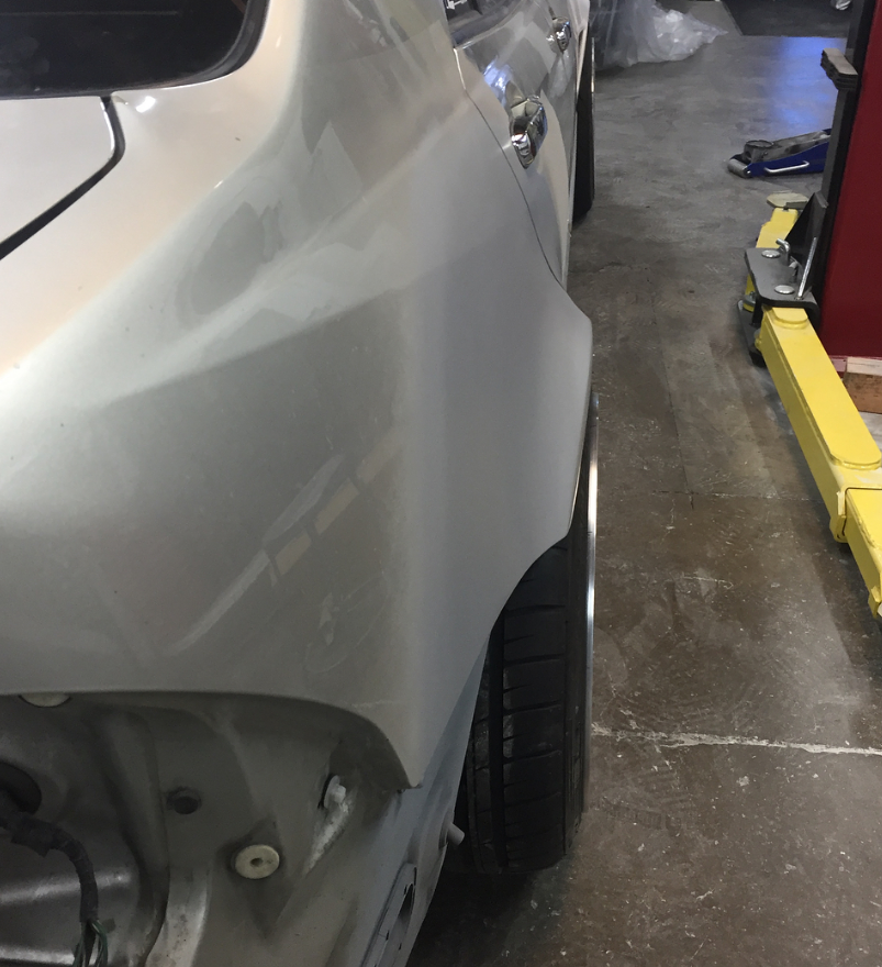

So the car went back down south to Kyle @ Pro Shop Noble to help execute the vision - Kyle is a bodywork wizard and a great friend. I hated the look of all the existing overfender options at the time and wanted something a bit more subtle with a better finished look. Kyle ended up pulling the rear quarter panel metal to be +25mm wider, welded a 1" rod to the arch to recreate the factory fender lip and smoothed the entire thing to blend with the door. He also matched the curvature of the arch with the rear bumper via plastic weld. Still super thankful he was willing to take on the job. I felt that the shape of the rear quarter would pair well with Vertex front fenders, which would all go together with an Elixir body kit that Kyle also imported for me. YAJ deals still existed at this point, ended up scooping an obscure hood (RS Hamada Silhouette Magic Carbon), Wald eyelids, a Gialla Corsa spoiler, and SSR Agle Premiums to go with the new look.

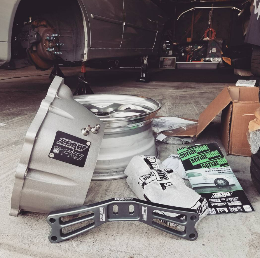

At the same time, I also decided the car needed a bit more power to match the look I was going for. I opted for a Spectrum SMR500 turbo with an HPI V2 bottom mount manifold, ID1050X injectors, Aeromotive 340 pump, and Power FC since the car was going back over to Rival Auto and it would work with the factory-esque wiring harness I was using. I left for vacation in Japan while Jason/Richard (B Side Fab) and Danny (Unrivaled Tuning) knocked everything out, car ended up making ~380 wheel on shitty California pump gas. Also asked them to throw in PS and oil coolers as well.

Decided to finally rebuild the Gartmaiers I had been sitting on, threw some helper springs in to lower the rear, and hit events with the car nonstop this way until moving to California. Was awesome just being able to load the car up with a pair of tires, add some oil and go drive.
After finishing grad school in 2016, I immediately moved out to the Bay Area and the world of drifting opened up like crazy - CLub Drift, Super D Cup, Good Luck League, Thunder Hill private days with friends, Grange - I was averaging 2 events a month for a solid year and a half. Got to meet my drifting heroes and partake in the first Vertex Festival at Grange/AVS right after moving (literally road tripped down solo ~7 hours with barely any tools, not the brightest idea in hindsight), then returned again for the first Super D Matsuri. My mind was blown and motivation was at an all time high. Ganadors and LED tails from YAJ made their way onto the car around this time.
Skip ahead to NYE 2016 @ the Animal Style compound, Julian convinced me to finally step up with an angle kit. Ended up scooping Heatmaker knuckles from him as well as DMax tension rods and some more poly bushings.
The car drove real nice, also added the Vertex hood lip/eyelids at some point too.

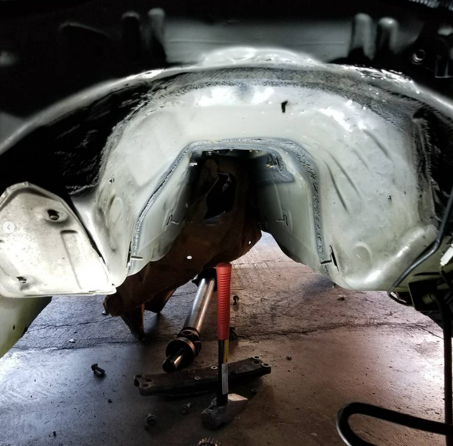

After 2 years of nonstop events and burning oil, the 250k mile NA 2J was starting to fall off hard, so I decided to take advantage of it and go 1J. Found one locally in Sacramento that came with everything plus a CD009, so yet again I began stockpiling parts. I absolutely suck at working on cars so the swap from start to finish took way longer than it should have. Ended up using Serialnine's CD Pro kit that just came out at the time with a Clutchmasters FX400 8 puck and 1 pc driveshaft. Austin Vernier (ily bb) helped out on the harness wiring and intercooler piping side since he's done the swap a million times from the JZXProject days. Literally think I pulled the engine/trans in and out probably 15 times between widening the tunnel with a big hammer and 0 power tools + the first engine rod knocking on start up - my fault for not validating what I was told from the seller. Big disclaimer that most of the work was with tons of handholding from the boys, during which time we decided Run Up! Drift Club would become a thing.
Long story short, got a replacement 1J from an importer in SoCal, ended up doing the Driftmotion high flowed CT15b turbo and Tomei elbow on the new one. At this point we got asked to drive Super D Matsuri 2 in 4 months, so I was in full scramble mode given that I was also starting a new job shortly too.
While the car was up on jackstands and apart, took advantage of the time to get the subframe powdercoated and throw in Serialnine solid bushings. Also had pinstriping wizard Zach Feeney lace up the Weld coilpack cover I got, still one of my favorite pieces on the car. Things seemed like I would be ready to go in time. Or so I thought...
To be continued in part 3.
