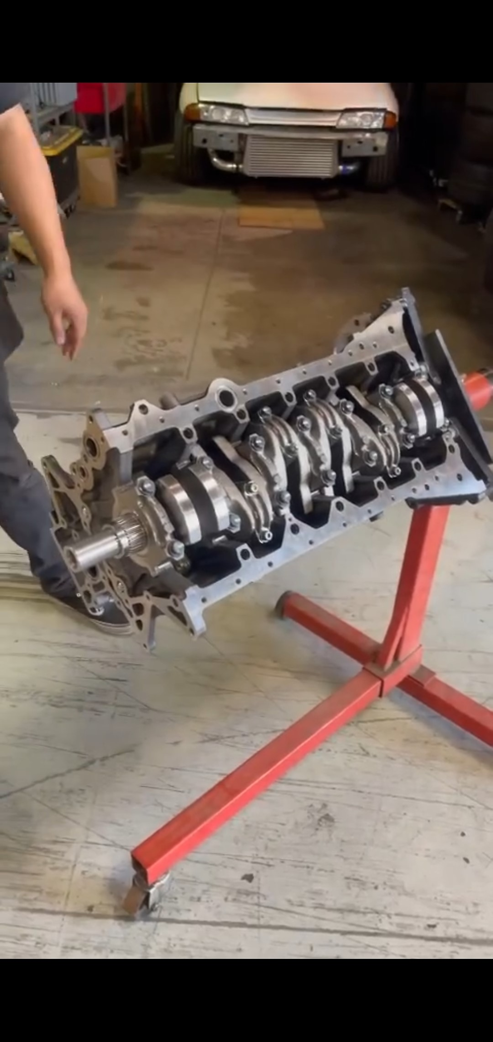

Special edition 2JZ dong piston version being assembled with Apexi HG
Head was inspected, for whatever reason there was light/moderate scoring on all of the cam journals. Small scuff later, should be fine
Mid assembly with BC 264 cams, mocking up the new manifold and turbo hotside. Determined the oil pump may have caused some of the issues above, so went with a Driftmotion upgraded unit for peace of mind.
Mostly assembled and back in the bay. Game plan is to clean up all of the ABS lines/accumulator pump in the back corner, eliminate any other wiring clutter up front if possible, and replace the AC condenser to get air con working.

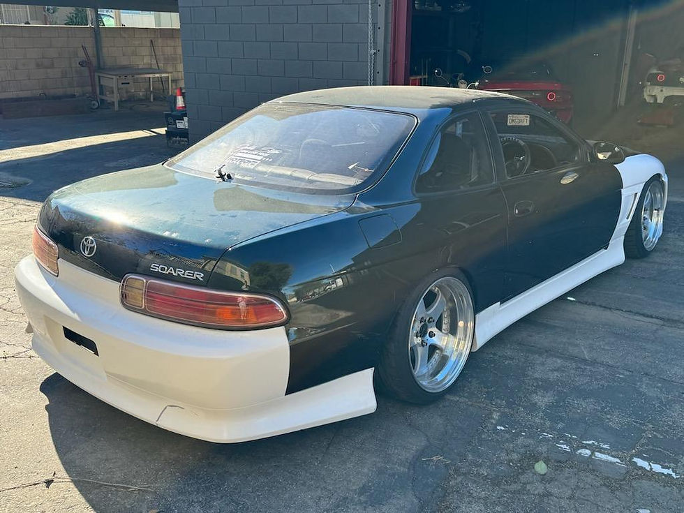

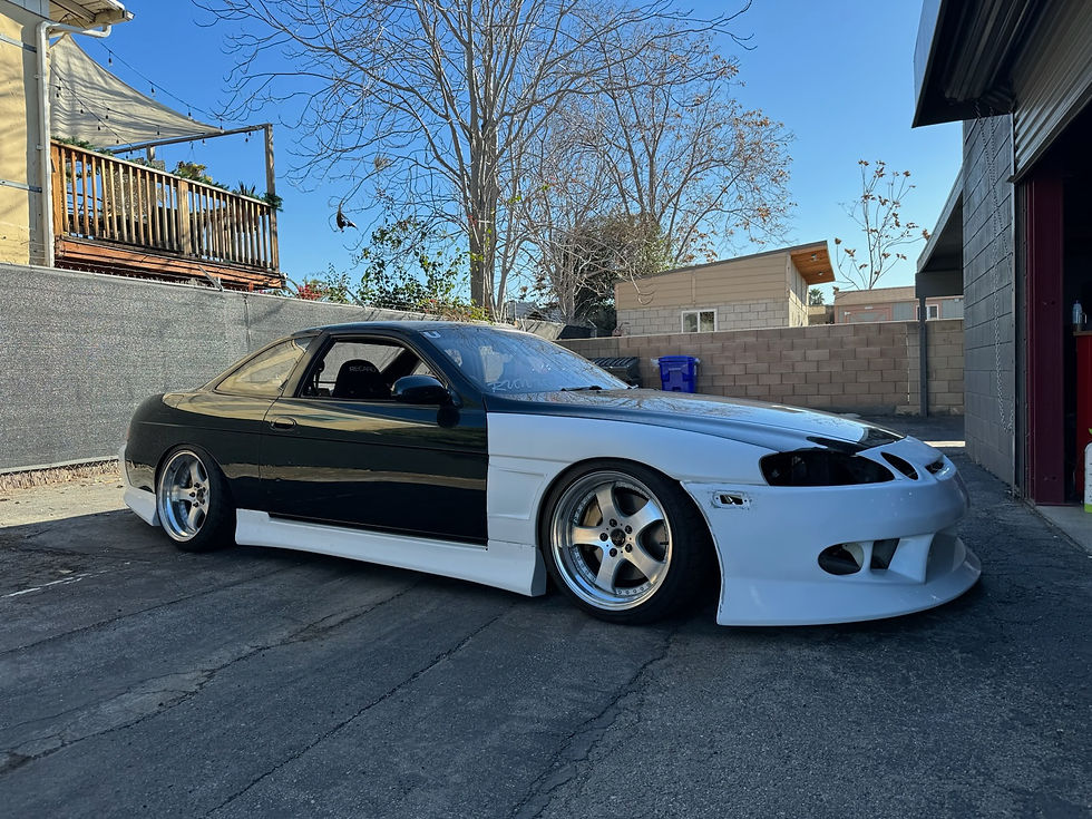

Vertex add-ons mocked up, car should be going into paint in the next week or two hopefully!
Stuff is happening. Car is currently at Pro Shop Noble in LA getting everything fitted/prepped for paint. Sneaky peeks below:
cant wait to see it with new kit and paint!
bros got the unmilited money glitch fr
Can't wait to embarass myself in front of the neighbors by stalling this car 19 times while pulling it in and out of the shop when it returns 😂 Really hope Jason is able to get it nice and dialed in for you.

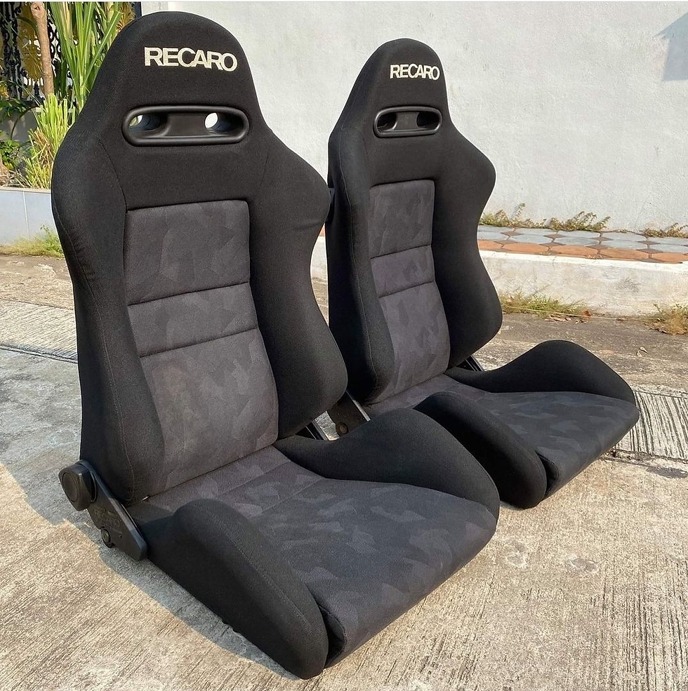

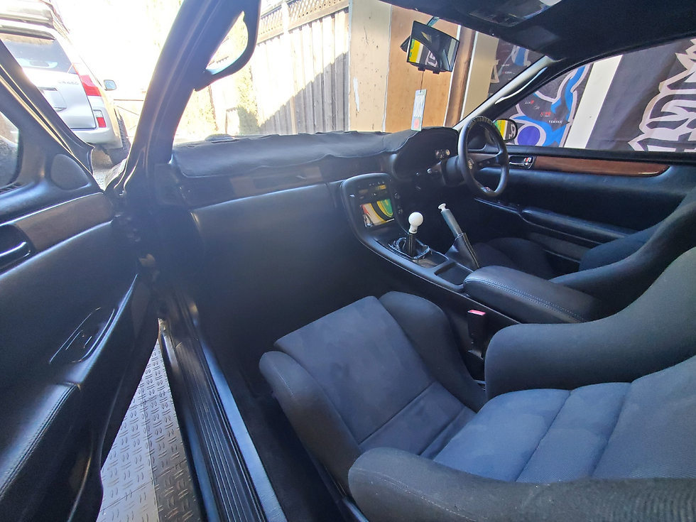

Meanwhile, I purchased a pair of Recaro SR4 Raptor Arista reclineable seats and Vertex steering wheel/shift boot/ebrake boot to update the interior with the black/white theme. Also picked up a Pioneer double din to replace the radio situation and got the climate control rebuilt with LED backlighting via Tanin Auto Electronix.
Decided to get creative with the gauge placement in the car after exchanging a few ideas back and forth with the previous owner Jack. Photos for reference of what he sent me:
Using above as a reference, I trusted my good pal Victor to use his much steadier hands to cut an opening in the wood trim above the glove box and had a local acrylics shop shape a tinted piece of acrylic to use as a screen with Tanabe Revel water temp, oil temp and oil press gauges mounted behind it. Picked up a white Greddy Profec for boost readout and mounted a Revel wideband in a 3D printed vent replacement to the right of the steering wheel. Also got rid of all the cracked vents and went with a 3D printed solution offered on eBay. Extremely happy how it all came out. (Dash mat was properly installed later, just didn't take a photo)
And that wraps up everything on the interior side. More continued in Part 3.
