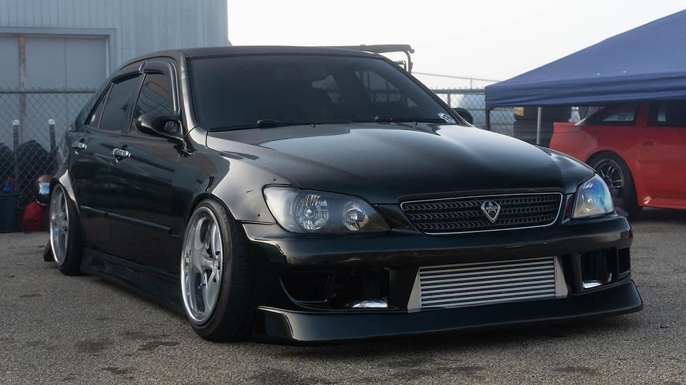

Here's a spec list of the car current day December 2023
2004 Lexus IS300 (factory manual)
Engine
1JZGTE vvti - fresh timing and seals during swap
Emu black full standalone by Ecu Masters
Tweaked custom harness engine harness
Audi R8 coils
2JGTE water pump w/ polished pulley
Serial9 solid mounts
UpFab top mount turbo manifold
Borg s257sxe .82 turbocharger t51r mod
Turbo smart hypergate 45mm external waste gate
FunkMotorsports Blanket
Mac valve boost solenoid
Radium valve cover fittings 10an
1UP custom IS vented catch can w/ drain
-10an coolant return from cylinder head
-4an turbo feed & 10an drain
Driftmotion intake thermal gaskets
ChaseBays Power steering Reservoir kit
6an 10 row p/s cooler
Tons of heat sleeve/protection all Raceflux brand
Whp Oil pressure, fuel pressure and IAT GM sensor
Koyo Radiator triple pass with koyo high psi cap
Custom shroud with dual 3200 CFM race fans wired on standalone thermostatic harness with relay box
BTI can gauge with electronic boost control & boost knob for tunes/boost levels.
Tuned by Sound Performance Bensenville IL
Fuel System-
-6an feed and return- all raceflux fittings & vibrant line (e85 rated line)
Aeromotive FPR w/radium mechanical gauge on fpr
Injector Dynamics 1050x injectors
Aristo hanger w/ Aeromotive 340LPH pump
Gm flex fuel sensor
Drivetrain-
Jzx110 verossa r154 (low mileage) shifts beautifully
Verossa shifter housing
Cubespeed billet aluminum shifter
-3an SS clutch line
Vertex shift knob
OS giken 559D twin disc clutch
Aisin slave and new inspection plates
4” aluminum 1pc driveshaft with 3150 joints
3.9 welded
Exhaust-
3” down pipe/3” piping
New rubber hangers, all v bands.
Vibrant bellows (flex)
Vibrant Ultra Quiet & Vibrant bottle resonator
4” SS blast pipes
Suspension-
Dmax jzx100 adjustable caster arms
New FLCA LH+RH
Stance xr1 22k/18k swifts
Jzx100 front uppers
Serial9 ak49 knuckles
Shortened spindles 35mm
Gs300 outter tie rods
Kfd rear arm set (LCA,toe,trac)
Figs solid rack bushings
Figs subframe poly insert subframe bushings
Powered by max solid diff bushings
Hotckis front/rear sway bars
Exterior-
BN sports kit
Don musk overfenders (front+rear)
Sxe10 Ganador mirrors with blue tint glass
OE stock hood
Altezza gita grill
Altezza tail lamp covers
Black housing headlights with LED low beams
Wheels-
17/18 vskf
17x9.5 et25 +30mm spacer
18x11 +10
— 18x10.5 +12 cr lie spares (4)
215/45/17 falken rtk steers
235/40 kenda kr20a
Interior-
Buddy club p1 seat
Sparco passenger seat
01 dash/console swap (non sticky)
Chasebays hydro with serial9 wilwood dual caliper
Double din. Upgraded basic speakers.
Steering hub with vilante leather wheel 350mm
25% tints all around
5% rear windshield
Battery relocated to trunk with waterproof breaker. 1/0 battery wire with fuel pump relay mounted on battery box. Billet aluminum tie down and bracket
10g fuel pump wiring from battery to fuel hanger Power and ground controlled for pump via standalone.

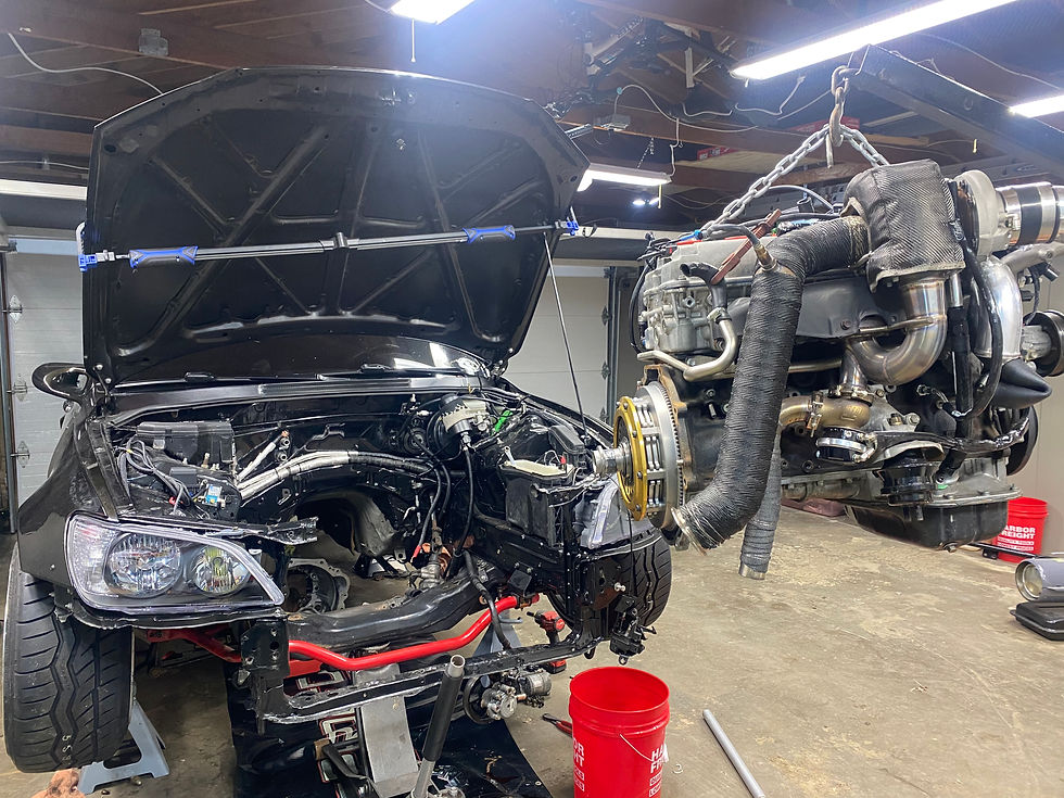

Winter of 2021-March 2022
Engine was pulled to clean up wiring, remove the stock ct15 turbo (surprised the wheel never left the chat) at 18psi being ceramic. W55 was removed and sold as a 5 speed sway for is300 chassis for auto cars.
R154 Verossa 110 retainer cube speed shifter
orc 559d twin disc
R8 ignition coils
Simplified wiring and brackets/hardware on engine.
Now was the smart time to remove and tap NPT for the cylinder head water return on the back of the cylinder head.

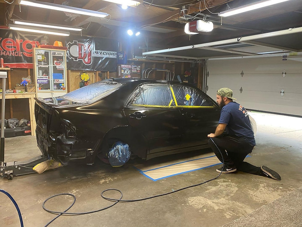

Bodywork & respray complete.
Don Musk overfender fit perfect zero complaints.
Black gold Pearl - Urekem Brand with EuroClear
Had a local collision shop work there magic on their frame machine. The manager of the shop has a good relationship with the repair shop I work for in town. $700 was a hell of a deal, pulled all the damage. Got everything in rear aligned perfect. No body work from them with the repair.
Waited few months for DonMusk overfenders from Poland & BN type II kit. Decided to respray the entire car after repairs

Decided on a whim, with zero painting experience, to prep and paint the car. My brother had a 1999 GS300 he started drifting as well. GS was stock 2JGE as well, basic suspension upgrades and chrome 3pc wheels.
Black gold Pearl 2 stage paint.
Painted with a Amazon gun and very small Compressor. As "rushed" as it was, prep was mostly just sanding as body didn't have to many dents. Obviously first time painting was full commitment to a entire car. Turned out very good.
Wet sanded the entire car & buffed. Turned out awesome and was very happy with color change and no more mixed silver fade of panels :)
