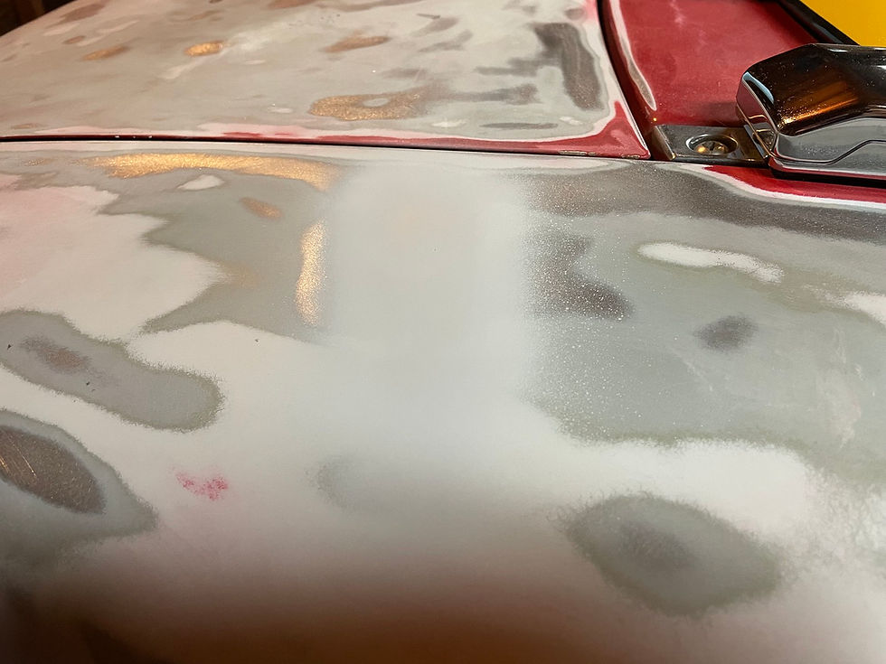

With a clean partially disassembled car, you can begin sanding the body. Wear a respirator while sanding! How damaged your paint is will determine the extent of sanding that needs to be done. All of the clear coat had failed on my car, with some other peeling/etc on my trunk. ALL FAILED PAINT NEEDS TO BE REMOVED. Painting over failed paint is a stupid idea so don’t even try. If your paint is in okay shape you can start with 320 grit and take off as much as you feel comfortable with. If your paint is completely shot like mine was, start with 180 grit to remove failed paint with the palm sander. Work your way up to 400 grit with the palm sander. Try to go panel-by-panel, I jumped around and I feel it slowed me down. I recommend using a foam interface pad between the sander and the sandpaper. Do not tilt the sander on edge while sanding to make it eat paint faster, keep it level to the surface. Replace the sanding disks more frequently than you expect to.
Damaged paint
DO NOT sand down to bare plastic if you don’t have to, as this will make the plastic “fuzzy”. I had to remove a lot of totally failed paint from my rear bumper which resulted in some fuzzy areas of bare plastic. To remedy this, I wetsanded the bare plastic with 800 grit, and moved up to 1500 grit.

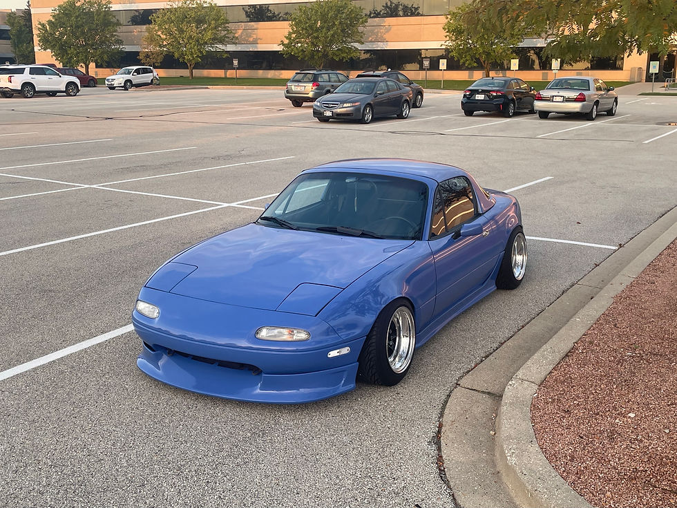

Once the paint is all cured, remove your tape and plastic and bingo bango you just painted a car. Reassemble and crooze. Don’t be lazy and be sure to clean every part during reassembly. I'll edit this if I feel like it later.

atleast it looks okay +15ft and in motion/wide angle.
