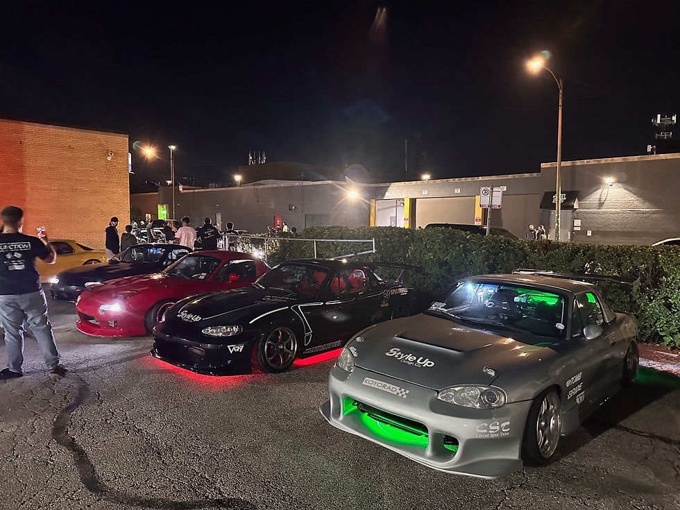

Figured I'd post my car and have it doccumented finally.
Ive had this car for the past 7 years and counting and have been daily driving / drfting it for 6 years. From stock power to boosted to now built with ITBs, this car has never let me down.
Lead Car: Me ; Chase Car: @JordanMx5
Track: Summit Point Motorsports Park
Event: Final Bout SSE 2023
First Event of 2023 in March @ Lock City Drift with new aero!
Build Breakdown!

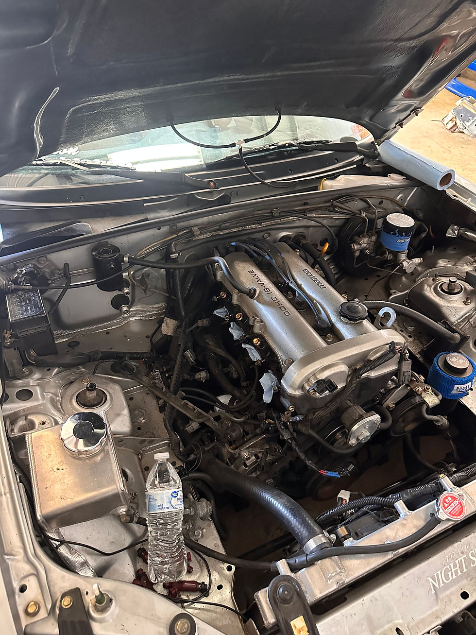

After a long year of not doing much, Finally added my NOPRO canards to the front bumper and just spent most of the year drifting and streeting. Motor developed low oil pressure at Staggered Motorsports Featival. Decided to pull it and have my buddy drop in a complete MSM motor with some bigger injectors and go back to the boosted life. Forgot how much fun having a turbo in these cars is.

Finally got to test out the car with the new Hummelink ITBs and the 3.9 gearing. Long story short, I love it. Car feels well rounded now and isn’t banging off limiter off in 2nd! TEs fit good with the help of some spacers. Also unexpectedly drove Final Bout SSE and got 4th place so that was a nice little weekend surprise. Unfortunately car developed a slight miss and needs some maintenance/TLC and a Túne. Hoping to have that all done sooner than later and hoping to get this to a dyno to wake her up a bit!

Made the impulse decision at the end of January to upgrade the ITBs and that started the rabbit hole lol. While waiting for my new set of Hummelink ITBs to come in (Still waiting), I sourced a 3.9 diff from YAJ, and swapped my Tomei 2way into it. The hope is that now my second gear won’t be as short so I’m not bouncing off rev limiter with my six speed anymore. My buddy Jordan also sold me a nice set of TE37 SL's so now I can say I’m part of the TE37 SUPREMACY.

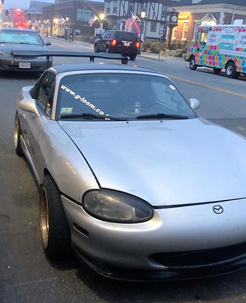

March 2018: After paying an arm and a leg to fix the diff, I had vowed to do all the work on this car myself. Took the car to a frame shop and they said '' its not worth pulling, but its also not gonna look good if you dont pull it.'' With that, I said screw it and drove around with my crooked front end lol. Finally got a set of coils and some obnoxious sized wheels and had fun with it. This was a turning point for me, I had always wanted to get into drifting but always had an excuse. But since the car was no longer ''too clean to drift'', I got to getting ready to hitting my first event.
September 2018: Still haven’t hit a drift event, but apparently had enough money for shitty mods like a battle aero wing and taped headlights haha.
