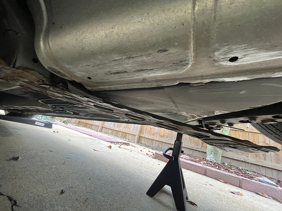

Happy to share this fabrication marvel Ryan Downey (@nismoboy67) cooked up for me,
I originally had Ryan weld in the gktech subframe bushings and we soon realized it wouldn’t be enough to solve my axle issues. I assumed we’d need to do the traditional cut and raise.
But Ryan had a brilliant idea of using an offset diff bushing to maximize the tip top space in the bushing hole. He even went as far as lathing the new diff bolt down to get the utmost height out of the opening.
He cut and welded the rear and kept the stock dowels for the bolts, machined brand new rear bushings to tilt the rear of the diff up as high as we could up against the dowels and got new counter-sunk bolts for the back. The 25mm raise with these mods + 10mm from the subframe bushings = 35mm of CV angle correction!!!
The best part is this setup is 90% transferable aside from the cutting of the subframe. Both F/R diff bushings are removable and can be transferred to another subframe should need be.

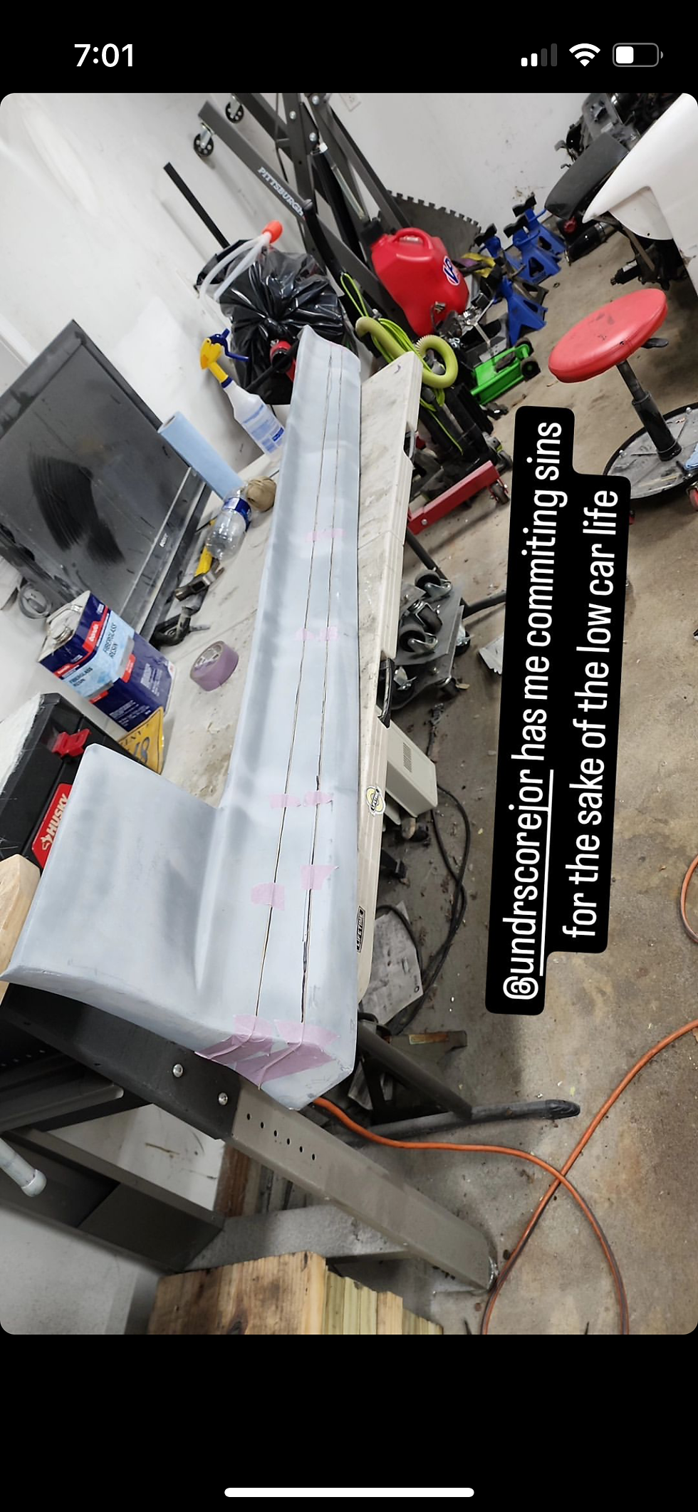

Skirts gone so I decided to got with another idea for aero I had in mind. JPF came up with their own BN style kit for the G. It is a one off kit as nobody makes anything similar of the sort when it comes to bell bottom style kits so I knew I’d be taking a risk given that knowledge and their “great” reputation.
Out the box fitment is pretty decent. But one problem, no way was that going to fit under the car, so it had to be shortened.
I hit up Nick @mspecautoglass to see if he’d be willing to take on the project if shortening the kit for me. Open to try, I brought the kit down to him and we started cutting immediately!
1 inch cut out the rear bumper, & over 1.5 inches out of the skirt.

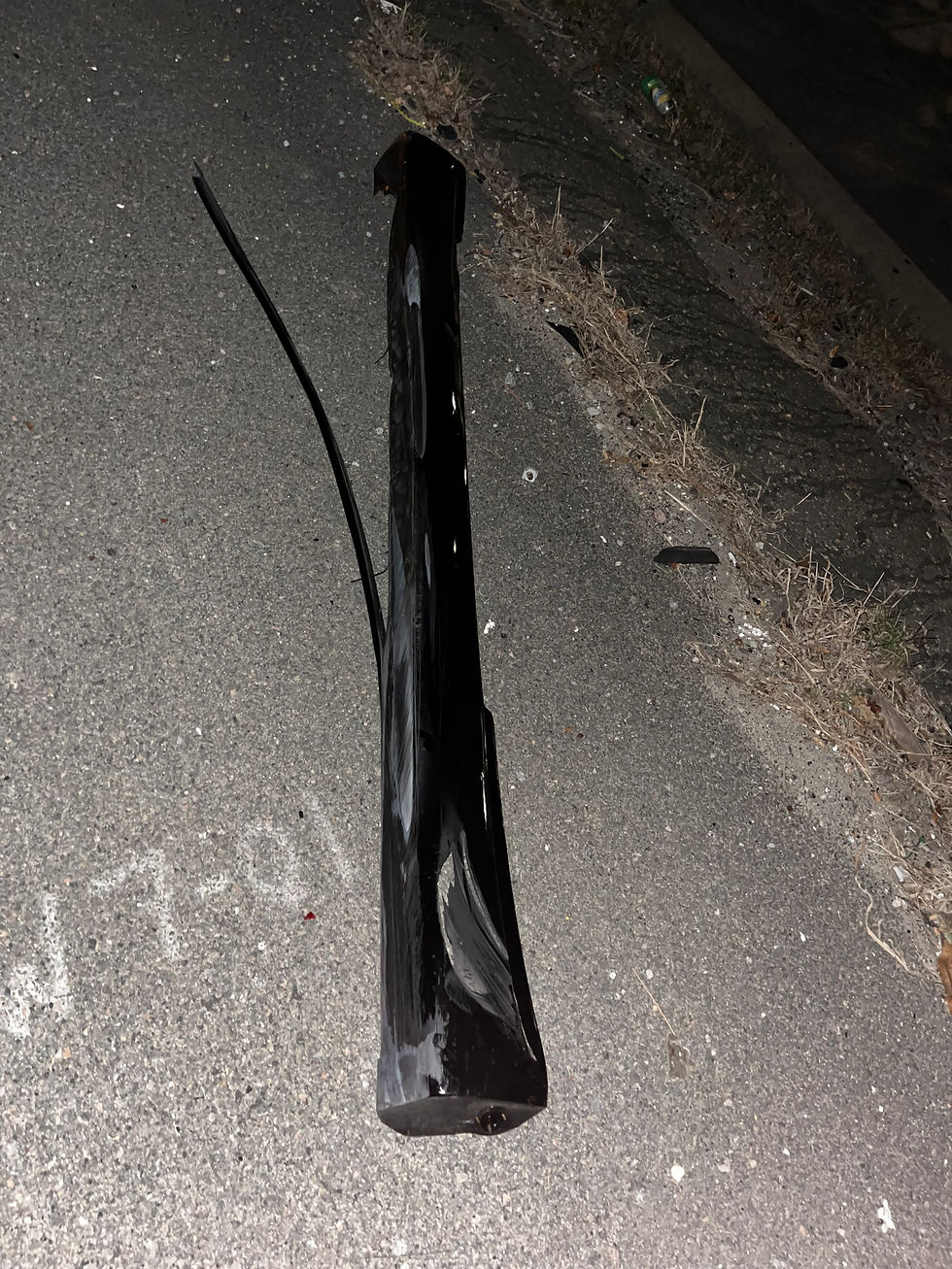

If you’re wondering why I have no skirts in the pictures, I ended up losing them on the freeway. I mounted them with quick release buttons thinking that’d hold up when I should’ve just hard bolted them up since they were KBD anyways. The skirts were constantly dragging and the KBD floppy material provided more leverage to pull the skirts off their mounting points. 2 hrs on the freeway and they were gone. Also right after I finally scraped through the heads of the subframe brace bolts and it fell on one side 15 minutes from home. Limped it home dragging it along the pavement and cut the brace out completely the next morning. Unfortunately that was the only thing between the ground and my gas tank, so now I’m trying to come up with a skid plate solution for that for peace of mind.

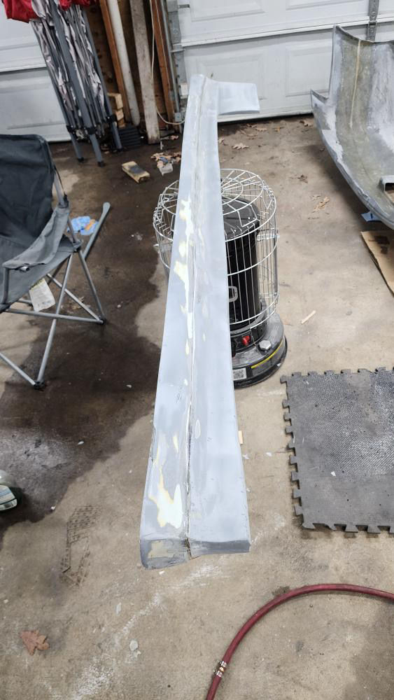

Got some new fenders, hammer and dolly them flat, and then added some resin to some bondo glass to thin out the consistency and skim coated the edge, blocked it flat.
With limited space/access to water in our tiny 1bd 1ba apartment, had to scuff the KBD material in the shower lol.

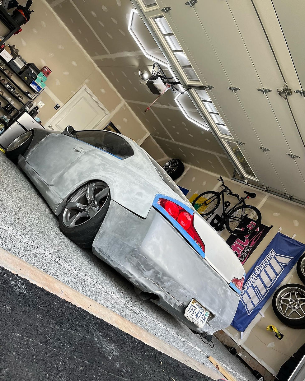

Finally taking the time to repair the obliterated front bumper. Lots of hours put on this while I worked from home lol
Now this was a dreadful time. Days and days of block sanding and reapplying filler bc of sanding too far, and primering the night of, and then sanding the primer off to work the filler again.
All in the comfort of my apartment complex’s parking lot.

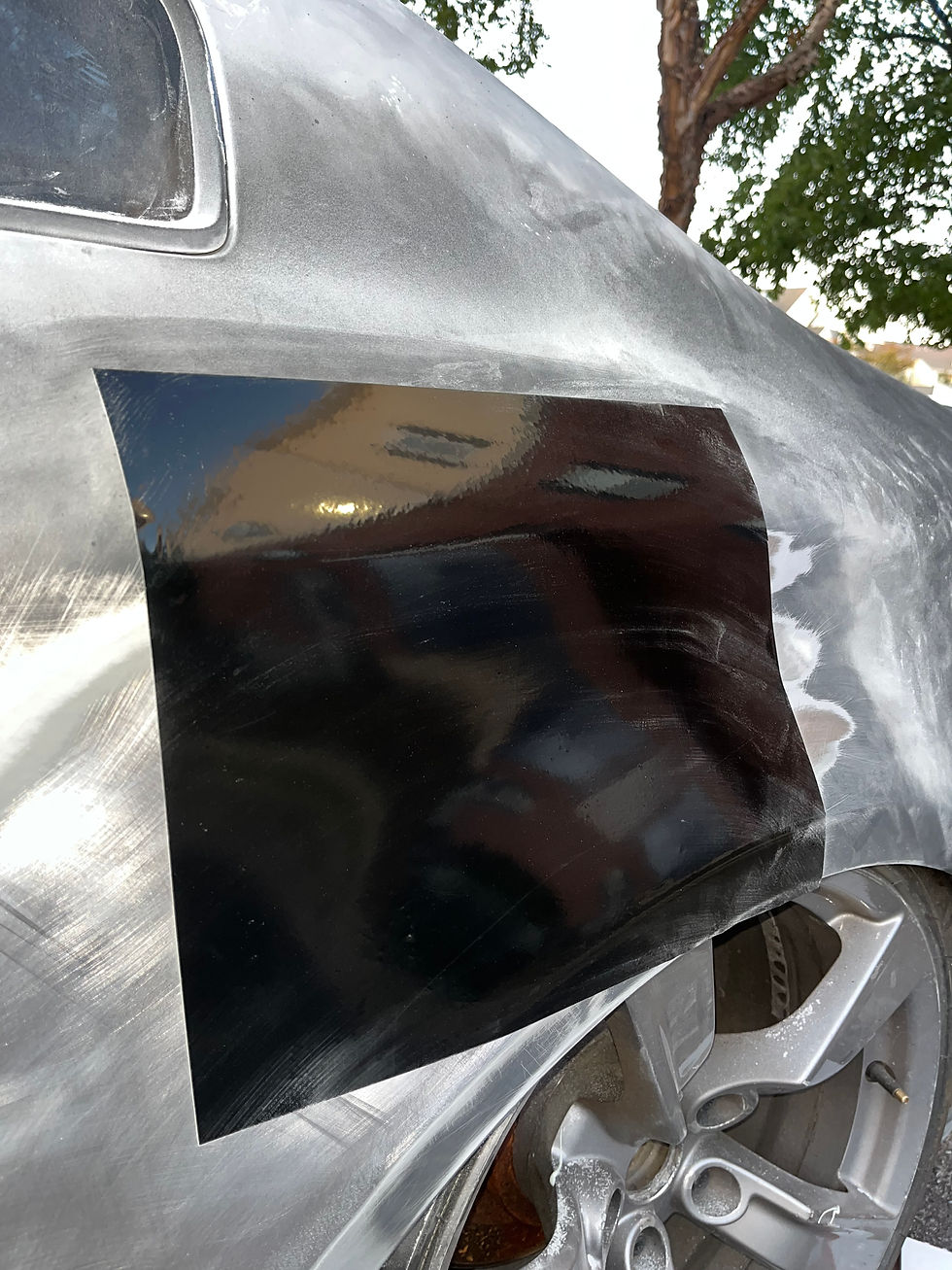

Needed to address the Quarter Panels on the car. Driver and passenger sides were dinged up and creased. I hit up Riley and he was more than willing to provide guidance and supervise as we tried to address the damage. He helped me with the fancy weld on slide hammer they have at their shop and helped me hammer and dolly the rest to straight as we can before a skim of filler on top.

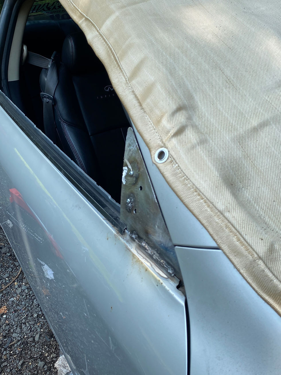

We're going to take a lot more work than I anticipated as the g/Z's mirror mounting area have a significant indent to the bolt holes. And the Bomex mirrors were flat. These are pics of it locked up looking okay but the bolts were only tightened halfway. Once fully tightened they sink in too much and hit the pillar and the door cannot close.
Put the idea on ice for a long while. Good thing to have friends with welders!
The homie Julius was keen to do a simple mounting plate for the Bomex's to sit against. Got the idea to replicate something like the Ganador mounting plates that they make for the Zn6/Zc6:
Template made out:
Cutting:
And welded plate to the door! (sounds scary/dumb i know):
Mocked up:
end result is so sick, can't thank Julius enough for entertaining my dumbass idea lol. Fitment isn't perfect, but it's just a mixture of the bomex's poor mold and the fact it isn't made for the car, going to cut and reglass one of these days, but for now, I'm happy!

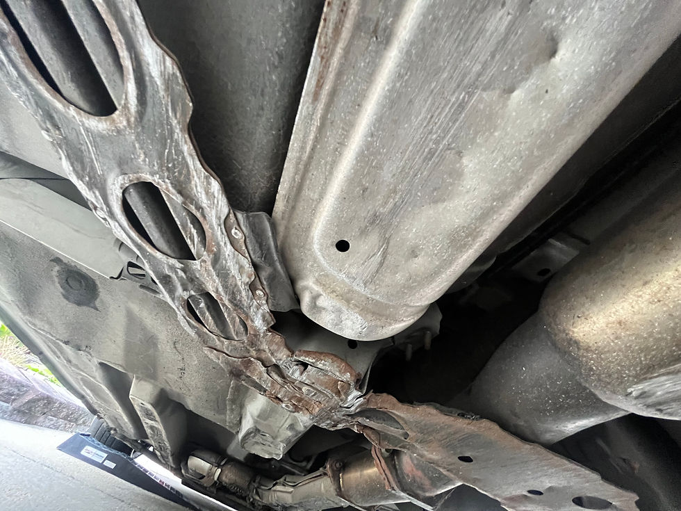

Well you know how it goes, Mo' Low Mo' Problems, scraped through my exhaust, and had my boy Riley from Roadstar patch it up with 1/4" steel. DIY oval! Thanks Riley!
Added some clamps to the hangers to raise the exhaust up. Unfortunately this fix is worn through now so back to the exhaust leak dungeon we go. Next setup I have I'm definitely going to try getting rid of the hanger bushing as a whole and run just the clamp to raise the exhaust up as much as possible.
