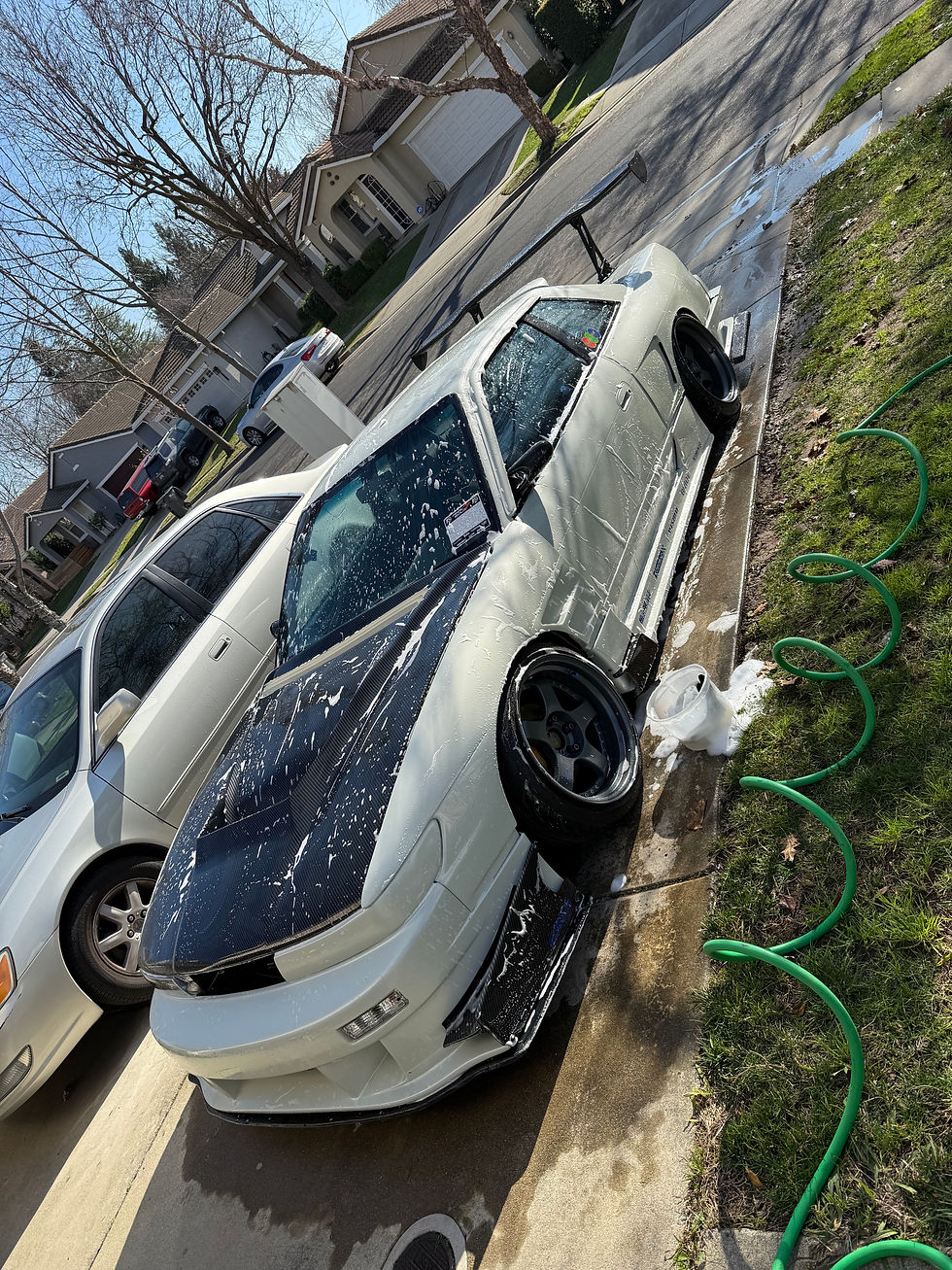

Car prep for GLL Practice day (1/11) - first wash of the year
Towing with a fresh rack felt so damn good. Didn't feel like I was going to die at all! The one fucked up thing though was a 30+mph headwind the entire way to the track. I couldn't even maintain 60mph (usually cruise at 70), which was a pain in the ass. I used 3/4 of a tank on the way there, but fortunately the wind was consistent throughout the day and gave me a little boost on the way home so I only used 1/3 tank! Usually it's 1/2-2/3 tank each way depending on how prepped I am.
