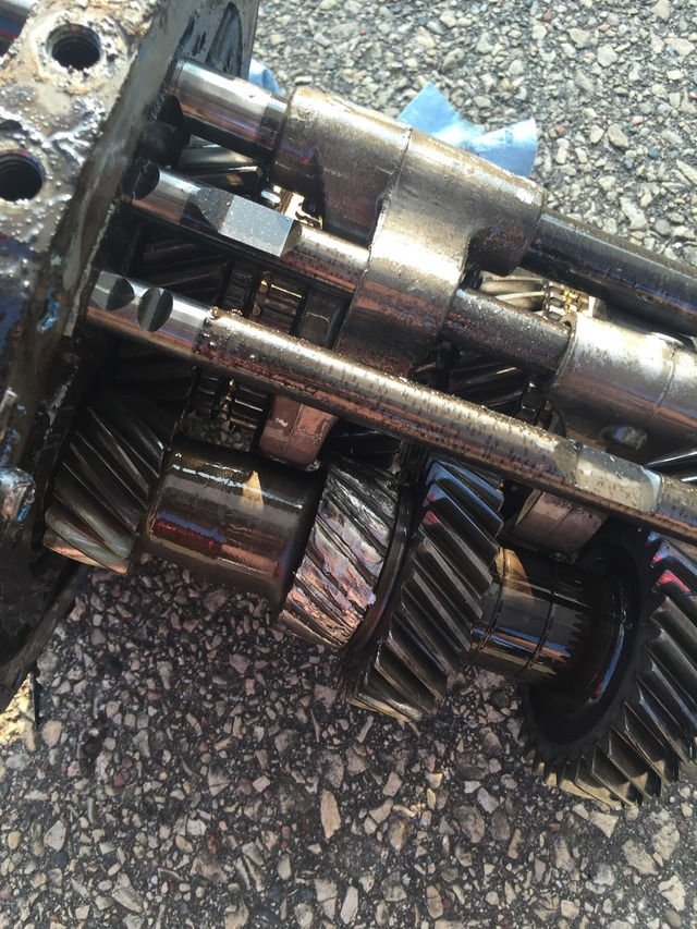

I ended up breaking 2 transmissions at FB2, which sent me down a rabit hole for the next 1.5 years. Finally I managed to get my shit together just before the first Super D Party at Grange (now AVS) and got a bunch of events in over the following couple years.

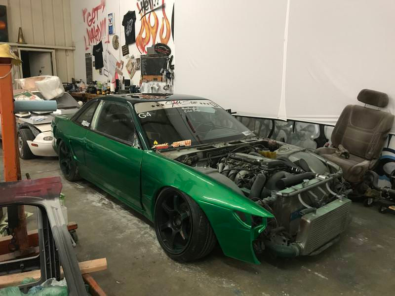

And then it was time for another change to promote Auto-Collect Storm (RIP), which I was involved with for a short period of time. Green turned out to be a bad luck color and I only was able to successfly drive a couple events until the motor showed signs of problems.
I had picked up a hatch that I was planning to daily and grip during the green car phase and after the SR in the green car seemed to take a turn for the worse, my focus shifted to the hatch, which quickly got out of hand...
I got a good deal on a Tomei exhaust manifold, which inspired me to go down the KA-T path. When I pulled the turbo off the SR to use on the KA, I realized the oil drain tube had a bubble on the inside, causing the oil to back up, which was the source of the smoke, not valve seals or any other issue with the SR ๐
I was too far down the KA-T route to turn back and fully comitted to the hatch and picked up some 326 aero and SP1's. It was a good car and I got it working/driving really nice.

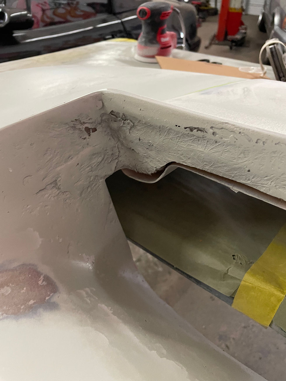

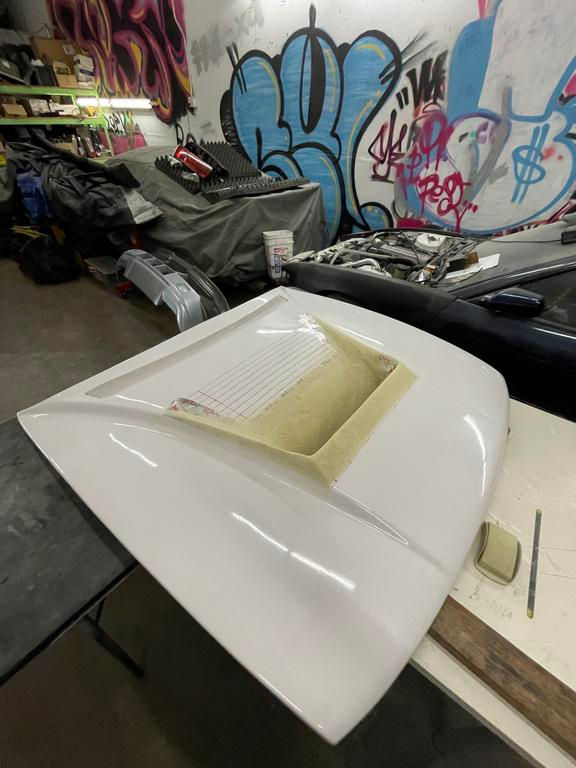

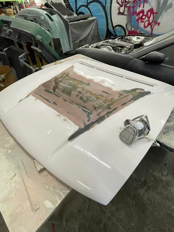

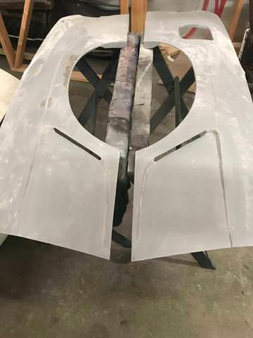

Final Bout prep kicked off with finally finishing up the hood. I went back and forth trying to decide whether I should fully remove the vent and start over, but salvaging what I already had done seemed to be the most time-efficient route though some day I would like to start from scratch again. The two main issues I wanted to fix were 1 - the transition from the area in front of the vent to where it had been grafted and 2 - connect and smoothen the backside of the vent to the underside of the hood.
I forgot to take a picture of it and I forget where I saw this technique, but I put some tape on the upper portion of the hood, where there's a good original section of the hood rising contour, and caked body filler to form a perfectly shaped sanding block. This worked MUCH better than the guess and check cardboard-cutout contour technique I had used previously.
After sanding and shaping a few pounds of fiberglass and filler, I brought the hood home for the finishing touches - painting and wrap. I hate to fake the funk, but I'm a ricer at heart. Jimmy did an amazing job wrapping the hood, unfortunately though, the heat from the header caused some of the adhesive to melt, which created a bubble, but it halfway looks intentional, so whatever!

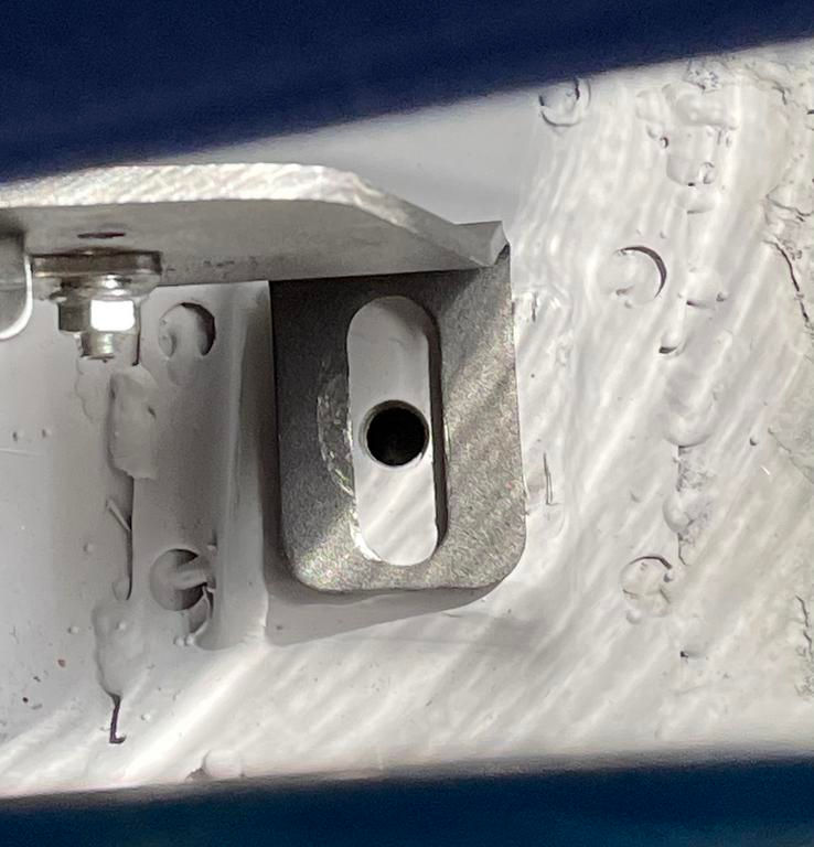

November 2023 - I got around to fixing the seat mounting point.
Corbin came to the rescue and plugged up the holes I made while drilling out the spot welds and then tacked it into place for me. It ended up lining up perfectly!

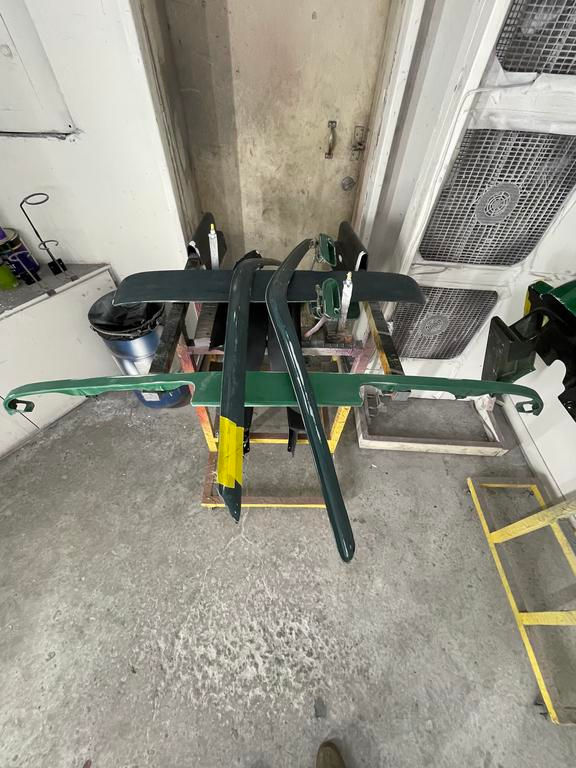

April 2023 - All of the aero bits and whatnot came out perfectly
But the car came out a bit too glossy. Satin proved to be a bit more tricky than I had anticipated. Poor Rus had to sand the entire car and spray the satin clear coat again.

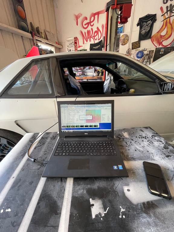

August 2023 - Corbin brought his computer and we dove in to try to figure out what was wrong. After doing a Zoolander "files are inside the computer" reenactment, we made some progress. It turned out that the software needed to be updated. I never saw a prompt or notification when I had "loaded" the base tune onto the ECU, so I assumed it had been successfully loaded, but apparently it hadn't been loaded at all. DERP

And added a bracket to make the dummy headlights fit better

Then it was tune time
The car died on the dyno and I had to run out and grab a new alternator
But after that it was all good and made 199hp 152 ft/lbs (228hp 174 ft/lbs when adjusted for the dyno)

Finished drop vent
Bonded to the hood
And started prepping for paint. If I were to do this again, I would have made a negative mold from the foam drop vent and then made the fiberglass drop vent from that. Trying to make the transition smooth with the way I did it is impossible without caking the entire hood with filler.

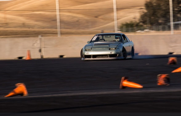

Then I drove down to Grange (now AVS) for Super D Matsuri 2. I didn't have time to break in the clutch, so I tried to break it in at the track the day before...
But I only made it a couple laps before I gave in to the temptation to spin the tires.
After a couple skids, the clutch started slipping. I tried my best to somehow get it to continue breaking it in in the hopes that it'd start gripping, but to no avail. Somehow I was unable to find any new SR clutches in LA, so I parked it for the weekend.

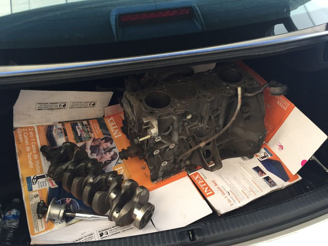

When I got home I picked up my first k24a2. Crazy how long it took me to actually put it in.

I wasn't used to the power and after a handful of runs I blew up 2nd gear, clutch kicking like I was still driving a KA.
I spent the second half of day 1 pulling the transmission and swapping the bell housing to fit the spare KA transmission I had brought with me. I actually tried to pay a couple buddies to do the work for me but after an hour sweating in the heat under the car they tapped out. Day 2 I spent the first half of the morning putting the transmission back in between moments of questioning why I was even bothering.
After getting the transmission back in, I went out and got 10 or so laps in before destroying 2nd gear again. I was exhausted and my driving was sloppy anyway so it was probably a good time to call it a day anyway, but not before I overshot a turn, went off track, and exploded my front bumper.
