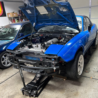

Got replacement parts from KPower. The adapter plate and hydraulic release bearing were out of spec. Thankful that KPower sent me replacements free of charge and FAST.
Did a bunch of little things to the car while it was down like an accesory fuse box for gauges and what not, added footwell lights, rebuilt fuel lines (had ptfe lines and the ptfe fittings went bad and kept leaking so I just went to normal fuel rated nylon braided hose and fittings from Vibrant), remade a dashmat, and some other things not worth mentioning.
Put the new KPower stuff on and the Exedy clutch kit. While I was in there I replaced the pilot bearing (tried the grease tool, had to use a normal puller), trans tail-shaft seal, and my driveshaft u-joints (never again… I’d rather buy a new driveshaft haha), and replaced the trans and diff fluid (why was this shit ever packaged in hard plastic bottles!?). Dialed in everything and so far have put 100 city break in miles on it and it feels great. Goal is 500 miles before the event, shouldn't be too hard. Just needs front end alignment to reduce the caster and some tires mounted.
Welp, the Miata is on jackstands... Had a very grabby/chunky clutch pedal and it looks like it was the internal hydraulic throw-out bearing. I was using KPowers previously recommended ACT clutch kit, but they have switch to ONLY recommending an EXEDY Stage 1. Apparently they were seeing issues combining their hydraulic throw-out bearing and the ACT? IDK... but a new EXEDY is en route either way; anyone need a Miata ACT clutch kit with less than 500 miles on it? I'll give ya a hell of a deal to help offset the cost of this new one.
Luckily KPower is working with me and inspecting the adapter plate and the hydraulic throw-out bearing to make sure they are in spec. If not, HOPEFULLY they make it right and send me good parts.

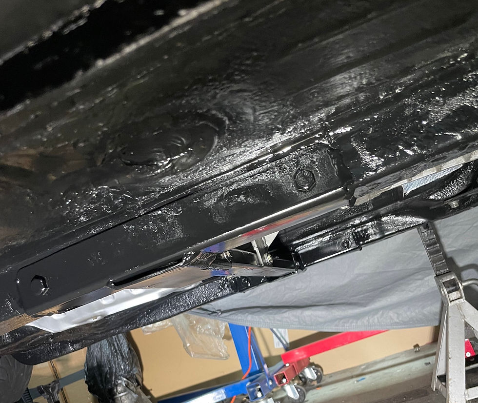

Snapped some photos of the undercarriage because I’ve only seen it on jackstands. Feels wild. For anyone wondering this is wire wheeled, degreaser, clean with IPA, self etching primer, rollbar and chassis paint, and seam sealed.
Still need to get a few things like front sway endlinks, make a skid plate for the front of the oil pan, rear subframe brace, modify the front knuckles. and get rear drop knuckles but it's basically "done" after the exhaust and ready to cruise around minus an alignment.
