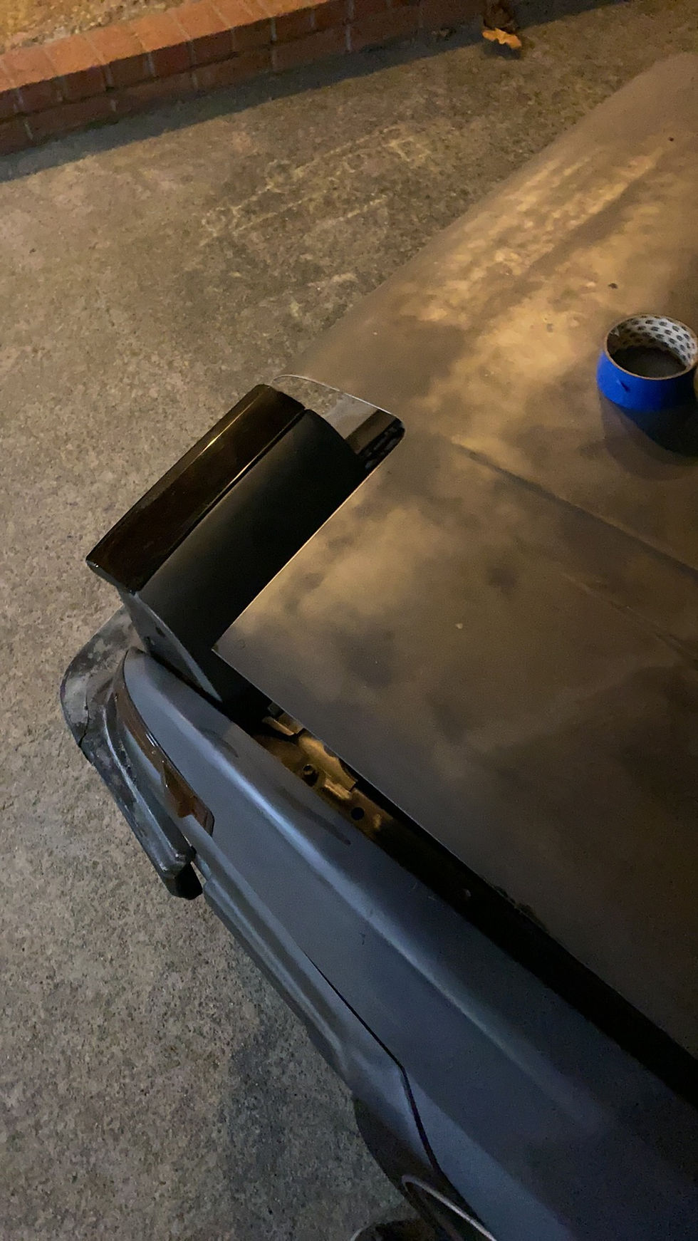

I got this goodline hood a while back from a good buddy. Unfortunately it got a little too close to a tree.
This was my mistake #1. Did not line the driver edge to match the OEM curve to the hood. Just went and had it straight lmao.
The template. Nothing like using a little cousin's car for my fiberglassing needs.
Passes the 10footer wide angle test. But see the fender peeking over the hood a bit? That's what I get for not doing the curve the hood follows. I'll probably redo it again down the line.

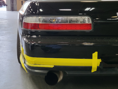

I'm an FRP noob, what is the general approach when you get fiberglass that fits poorly? I'm going to assume heat gun will be worthless. I don't want exposed fasteners, and I feel double sided tape would likely fail.
Image below is not mine, but is of the same lip I have (Ondorishop G-Grow). I don't really see which direction of sanding will be effective. Halp.
Also depends what part of the piece you need to fit. In my experience, I just cut things up and refiberglass parts into new positions or recreate them entirely
For a simple example, this rep bumper wouldn't mount at all until I cut off the parts that wrap around into the fender.
Other than the part I cut off, I think fitment like this would be considered "fixable" with a heat gun ( but I've never used a heat gun on fiberglass)
I'll have to get back to you with more detailed information since you seem like you harbor useful experience. Of what you shared, it would be closest to the first photo of the teal bumper. As well as a gap in the pic I shared at the top edge of the FRP where it runs horizontally above the exhaust.
"Poor" as in this kind of fitment:
Or "poor" as in absolute TRASH fitment:
